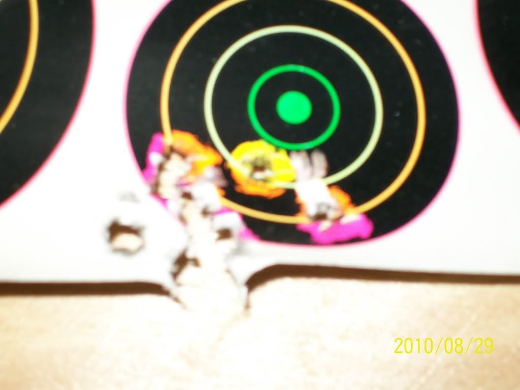

Yesterday I had 5 stragglers I needed to download , they were loaded with both hornady and lapua brass, and I shot a 5 shot group with my hunting load as well, which is 51.2 grains RL17 and a 130 VLD hunting and target mixed (2 hunting, 3 target) CCI250 (trying something different) at 3.189 inches COAL. Velocities ranged from 2813-3203, all five of the hunting loads mentioned read exactly 3203 and did it again this morning but one was 3204(dangit!!!) The other bullets were 1 140 grain VLD, and 2 129 SSTs. That is four different bullets, the target bullets have a thicker jacket, 4 loads, 3 powders two brands of brass and 3 primers with a whopping 390 fps extreme spread, all fired across a chrony. 10 total shots, ONE 1.2 inch group. You don't have to point out that my gun is not zeroed. I will do that next weekend. Average velocity was 2980 if that matters to you! ;D You made a wise purchase, I have to say again.
Apologize for the size of the photo, I don't have a decent photo editor on my laptop and I am at work.
P.S. i am only half bragging, and on the gun not my shooting or loading, the other half is for your encouragement Kendoka. this gun has 270 rounds down the tube so far and some may say my barrel life is half over, I may be completely wrong but I don't think it is. I clean it every 20-30 rounds still, and it seems that it helps some with carbon fouling. Also I have to say that unlike all of the articles said, Mine shows only 6-10 fps difference in velocity from turning the brake on, some higher, some lower. having it open does seem to open my groups 1/8 to 1/4 though with most accurate loads.
CF, Sounds like you are enjoying your LRH!. Remember Rifles are like women some take tender loving care and can be quite finicky.
