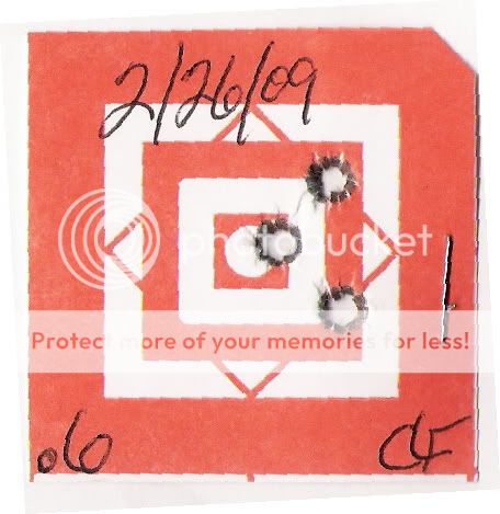

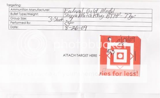

The simple answer to your question is yes. One of my cheap stevens 200 builds with a cheap .22-250 barrel and cheap stock and a BSA scope has printed a .158" 3 shot group at 100yds. Normal is more like .200"-.250" C2C at 100yds but it has the potential to do it. It's hard to argue with that kind of accuracy from a rifle that I only have $550 invested in total with scope.

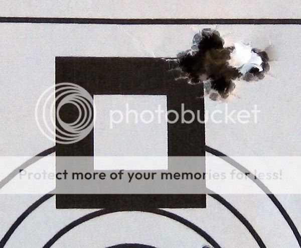

There comes a point where an action is as ridged as it needs to be, and anything further is just over kill. The Savage repeater actions are at the point that they are as ridged as they need be. A buddy of mine, and I both have Savage bench rest rifles, (With work from Sharp Shooters Supply) that will fit into IBS/NBRSA 100-300 Varmint yards light gun. (His is a target action mine is a model 11 action.) We also both own Bats. (Both of his are SB both of mine are S.) We both agree that our Savage's shoot on par with our Bat's. My Savage has shoot many 5 shot 100 yard groups in the .1's with both a 6PPC Krieger barrel, and a Douglass 30BR barrel. (Best groups being a 122.) My buddy's gun has as well, with a 6PPC Krieger barrel. I have also done very well in the long range game shooting an old Savage 110 I got out of a pawn shop. The fact is a Savage will shot every bit as good as any Remington.
The down side of Savage is first, the amount of aftermarket parts available. (About 1/2 of what is out for a Remington.) There are only a handful of true Savage gunsmiths. (What works on a Remington, doesn’t necessarily work on a Savage.) A Savage action will have some slop in the bolt (Heck, it is a mass produced action.) and there is little that can be done to remove this. The upside of Savage is you can buy off the shelf aftermarket pre-fit barrels cheap, and have them in a couple of days. If you send the actions off to Sharp Shooters Supply for a time and true job, they can take the bolt lift down to something that is comparable to a Bat. (This is done without cutting coils on the firing pin spring.) You can change bolt heads and go to just about any caliber you would want.
The targets you see are good, and are typical.

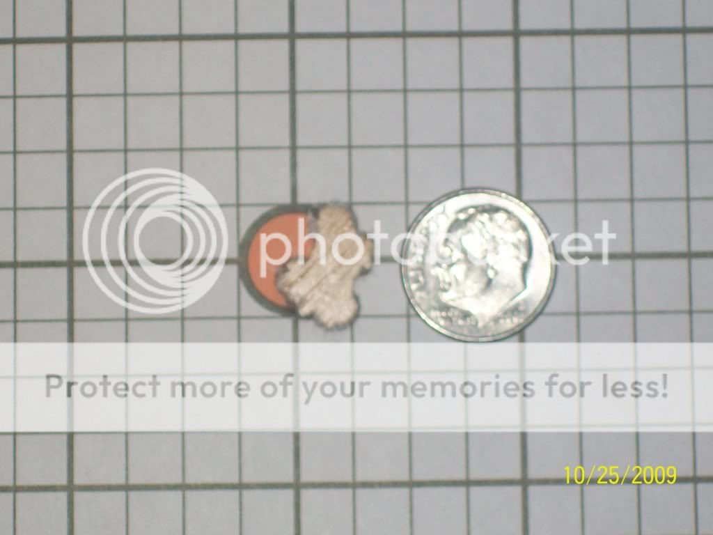

Here are a few pitures of 5 shoot 100 yard groups I have shot with my Savage modle 11 with a 6PPC Barrel.

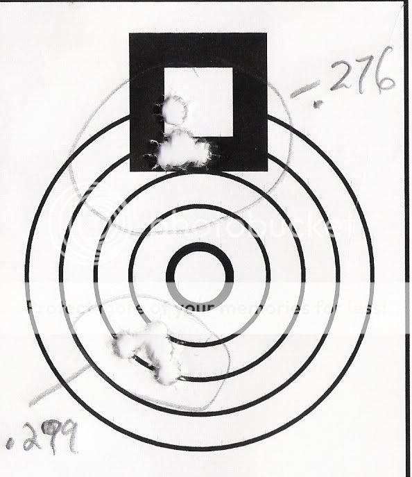

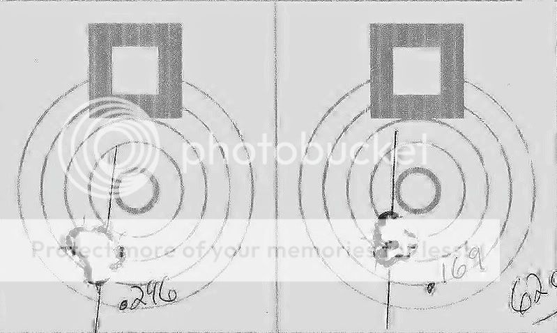

These couple of targets are shot with the same gun Modle 11 with a 30BR barrel. (Only have 50 rounds down the barrels.)

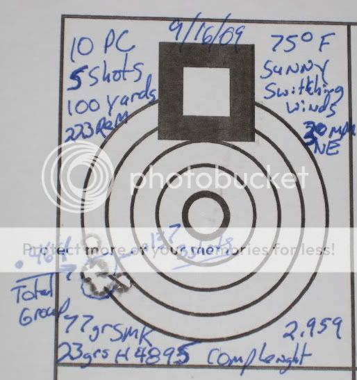

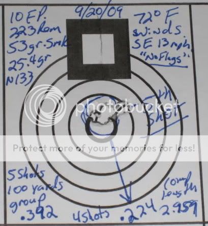

Yes a BVSS stock will fit your model 11 action. Savage only offers two actions, a long and a short, everything else is a variation off of that. With that said your action is the exact same action used in a modle 12, and it shares a lot with the target actions. Bacisly the only diference in the target action is they have less machining. It would depend on the club what they except as far as a factory gun. I can say one thing a model 12 will shoot identical as a target action. Here is some pictures of 5 shot 100 yard groups I shot with a out of the box model 10 Precision carbine.(Just about the same gun as your model 11.) Same action as yours, and the model 12, in a plastic stock with a barrel that is inbetween the Varmiinter profile (Model 12) and your sporter contour. (Model 11)
Here is the Factory Savage test target for that gun.

And here is a 5 shoot 100 yard groups shot from a model 12 benchrest in 6mmBR
