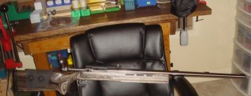

Well after much thought & angst, I made trip to Midsouth and bought a Rifle Basix2 (based on youz guys feedback and some others) and installed it this evening. Easy install (about 20-30 minutes) and have it set at 8oz, safety works consistently (Passes buttstock bump test) without any deviation of my initial trigger pull weight settings, and I'm very pleased with how much adjustment it has.
Happy ;D
Cheaper than a BAT (which I'd like) and it'll really help me hold my upper body/head position on the mat and stock, not having to re-cock, that cost me a lot of points last time out. I'm already calmer.
Thanks SO much guys!
Here's a few pics of it finished up:
