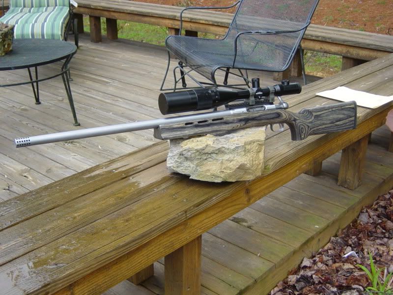

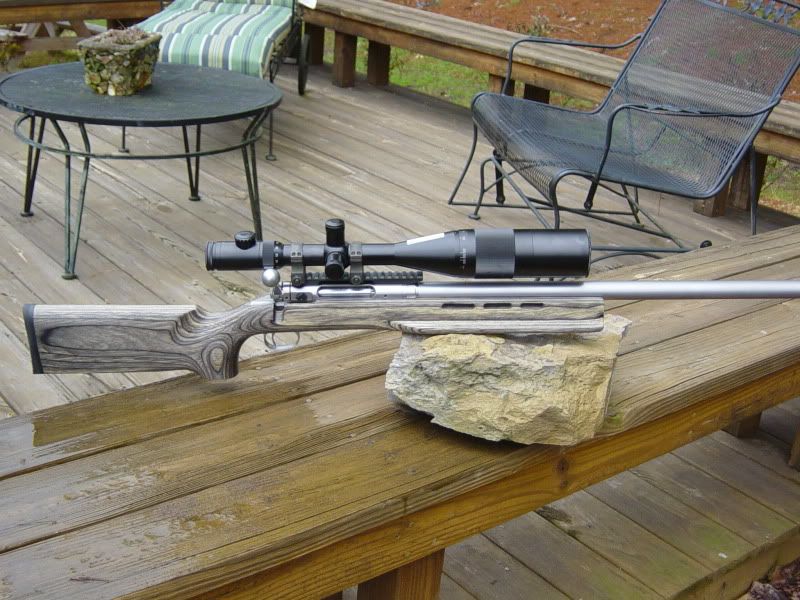

My Ole Salvage Split Port 6BR
told me a few months ago that
it was sick of all the fun the Rugermites
and Remchesters were making of the
4" = 200 yds groups it was shootin'=
so Ole VolDoc ordered a new Hart 20 cal
9 twist barrel and sent it off to Kevin Rayhill
of Stockade Gunworks fame and low and behold
"The Big Brown Truck " brought it Home
to Moonshine Mt. yesterday=
Ole VolDoc only had 3 pieces of Brass trimmed
and necked down so that's why the 3 shot groups=
Had a new bedding job done also so it will remain
Factory when I slap the 6BR Salvage Factory barrel
back on for the
BBB this Spring=
Don't look too BAD for a Salvage Split=
It's chambered for a no-turn 20 BR=
Just Barrel Break-in this AM=
but looks like it wants to shoot=

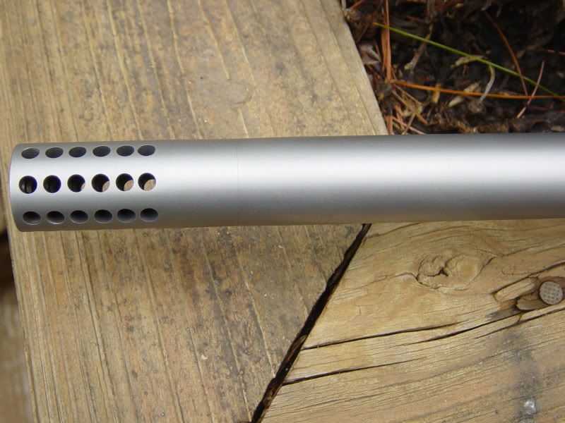

Muzzle Break is Kevin's own design and workmanship
is superb=
can't hardly discern the seam in good light=
and recoil and muzzle jump is Non-existent=
My Goal is to Kill a PrarieDog this year with this 20 cal
past 1,000yds=
55 Berger 20 cal bullet BC= almost .400
and velocity is near 3,8000fps= Dog Gone=

Looks cool.
Any paticular reason the front ring is so far back?

Is that a factory stock or aftermarket? Your rifle looks really nice.I put 2 together ,one in .260 rem and one in 6mmremington.One is a varmint 26" tube and the 6mm is a bull in a bvss stock with a long action /centerfeed and the bvss accepted the bull barrel with only slight mod of the last couple inches of the forearm barrel channel.I cant wait to shoot it.I put a 3 screw in the .260 and an sss trigger in the 6mm.I got the sss from brownells in 2 days as I have never been able to get through to fred.
