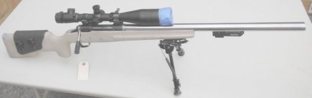

I have two of the 12FVs from cabela’s: a.223 and a 6.5. The .223 shot dimes with my first 50vmax handloads. But I intended to shoot longer range with it so I rebarreled to a 7tw CBI with a longer throat. The oem barrel is in my spares, barely 200rds through it. The action on this rifle is relatively slick for a savage. The factory blind mag drags the bolt so a new stock really helped. I removed the bolt buffer to get full short action throw with .223 aics mags. This rifle is my primary shooter for anything 600 or closer.
