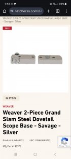

Can someone give me a model number for this? I'm trying to find one, but wanted model number to just verify. I'm sure 2 piece is going to be the answer, but looking for a 1 piece if possible, and if they made one. I'm just trying to figure it out with all the different action lengths.
Thanks in advance to anyone that can provide some insight.
Egw still makes a picatinny rail for it as well.
Pt# 41300 for a 0moa base
Pt# 41302 for a 20moa base
After clicking on the link and going to the site, hit the filter button and select Savage, then Savage “MEDIUM” action
Yes, kind of but after all the cleaning of info, my action is 4.52, there was a 4.27, then a 4.4 action spacing. From what I've learned I should be able to use any 2 piece flat back scope base. I ordered the one I showed earlier to see if it works, and the dove tail works with my leupold dove tail rings.
Yes. For a 2 pc set it will work as long as it is for a flat rear action. Weavers site states the one you mentioned as for a pre 2003, so it should fit just fine.
