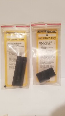

I've mounted scopes on many Sakos over the years, and much prefer the Weaver bases. They are solid, strong, reasonably priced, and easy to install, although there is a bit of a knack to it. You would need nos. 66 & 67. Here's a set on eBay:
Also, a pic of one of mine
very neat
