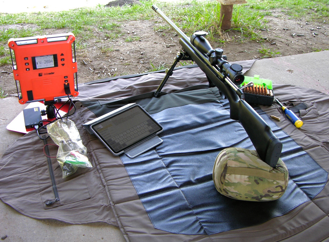

What I've added is as follows. A Zeiss Conquest V4 6-24x50 (moa) scope. I upgraded the original aluminum scope rails with steel Warne bases. Those rings are by Burris and have the 20moa inserts installed. You can see a very nice ATRS brake. I also had the sling swivels on the fore end replaced with a picatinny rail for more mounting options. And in this picture, I have one of my Atlas bipods (which got replaced - more on that later).

I entered the speed into my Kestrel and backed up the Applied Ballistics software with shots out to 300m, 500m and then 800m. Everything seems spot-on, at least to 800m. I will be taking the rifle out to the mile range to see just how it performs to a kilometre and beyond.

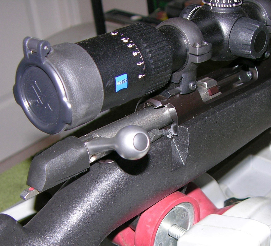

My impressions are favourable for this, my very first Sako factory rifle. The action was very tight to begin with but after 200 rounds, is as smooth as silk. The Sako bolt is a 3 lug design. The bolt handle has a nice large knob that is easily cycled. The safety has a pretty cool function too. When you have a round chambered, you can engage the safety which disables the trigger. But, you can manipulate the bolt and eject a live round without fear of the trigger breaking. You can also load another round, if you so choose. And the trigger will still be cocked.
