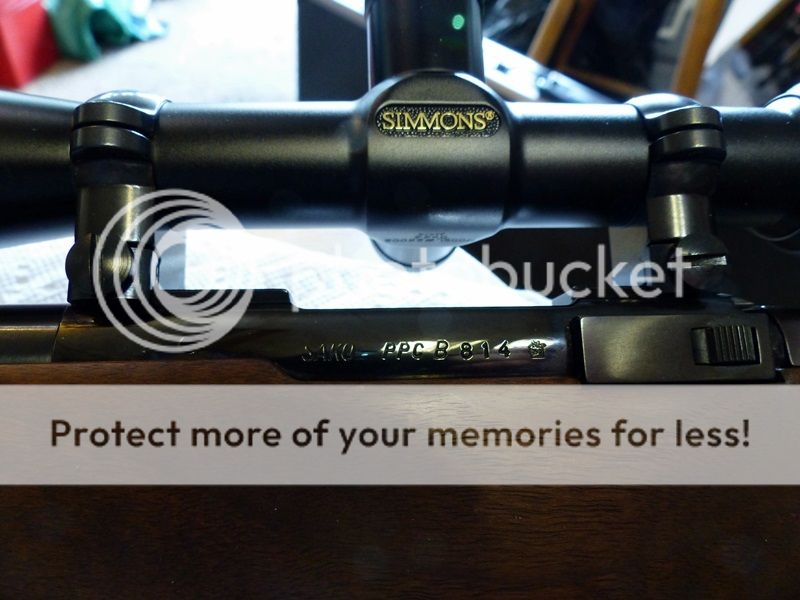

Just got a very nice condition Sako 6mmppc heavy barrel single shot.
Came with 50 fired Sako Brass and 40 new brass.
I neck sized brass and loaded some 65gr V maxs and 70 gr Sierras using H 322 powder.smallest group 5 shot was .250" with V max and 70 gr sierras
When I close bolt its quite stiff closing, fired brass not loaded is stiff closing.New brass is smooth as well as fired brass full length re-sized.
I looked at chamber with bore scope, seems smooth and no marks.
There are no marks on brass after cycling in chamber.
Whats your thoughts
