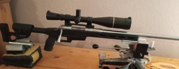

I'm happy with my XLR Element chassis I just made a couple bag riders for it that I will get anodized sometime.
Maybe I can get a picture up later.

A couple pic's of my XLR Element chassis

Oh baby!..that nice..what caliber, and how does it feed?..any modification needed..or was it 100% plug and play
Thanks for pics
Right now it is a 6.5x47L .
Feeds great aics mags and very accurate.
Haven't bothered to bed it yet.
I may at some point put a indicator on it and see if I need to.
Like I said I just made the bag riders that just use the existing 10-32 screw holes with standard socket head screws.
Right now it has a single shot mag in it I picked up somewhere I could have just made that to being a machinist.

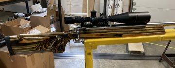

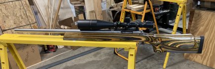

How about one like this? 3” wide forearm.
