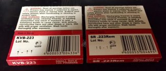

Could anyone tell me difference between the two ones in the pictures?
The KVB-223 have copper colored cups
The SR .223Rem have brass colored cups
Till today I used the copper cup for my hot F TR loads with Palma cases with no issues.
I'm not sure the brass cup primers are same of copper cup but a thicker cup.
Did anyone already use them for a feedback?

Wolf/Tula Small Rifle SR #KVB-223 - soft, sensitive copper cup, not recommended for AR15/military rifle use or high pressure rounds.

Wolf/Tula Small Rifle Magnum SRM - hard, less sensitive brass cup intended for AR15/military rifle and high pressure rounds - #KVÐ’-5,56M.
Wolf/Tula Small Rifle 223 SR223 - #KVB-223M "This is the newest primer available in the Wolf line. It is ever so slightly hotter than the small rifle magnum primer and it comes with a brass colored thick cup. This primer can be used in place of the SRM primer or used when a different powder is used that is hard to ignite."
