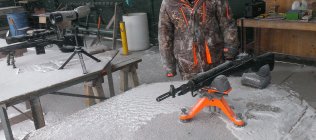

Heat doesn't stop me from shooting nor does the extreme cold we get here. I shoot outside when it's -5 f ( -20 c )... I've shot in colder condition, but if there is a strong wind when the temp is at - 15 f ( - 26 c ) with 40 mph + wind, I skip shooting on those days.
:eek:
Here is a pic of one of those freezing windy days at the range...
[ it's not snowing.. that's just the wind blowing the snow all over the place. Only reason we made it to the
range that day is cause we put tons of work on Buddies Jeep Wranger (Walter on the left of the first picture, RIP Brother !. his Jeep could go anywhere in any weather. We built his Wrangler with the best components money can buy.]
On this day 90 % of the roads were closed and monitored by the OPP ( Ontario Provincial Police )
