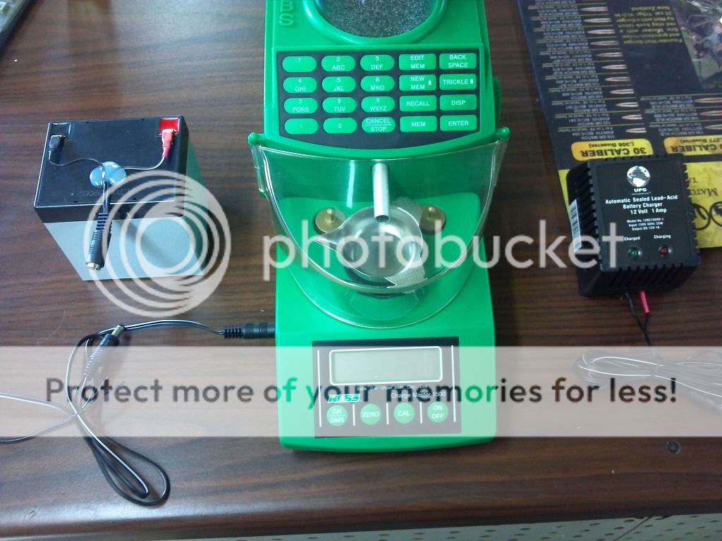

Here's a pic of one that I make.
Mike's works like a charm. I've been using for a couple of years. Very convenient to haul to the range.
