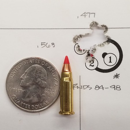

I converted it to a Whistle Pig .17 Mach2 which is a sleeved aluminum barrel threaded 1/2x28. It's now an exceptional squirrel gun and the barrel made it lighter w/ better balance.
