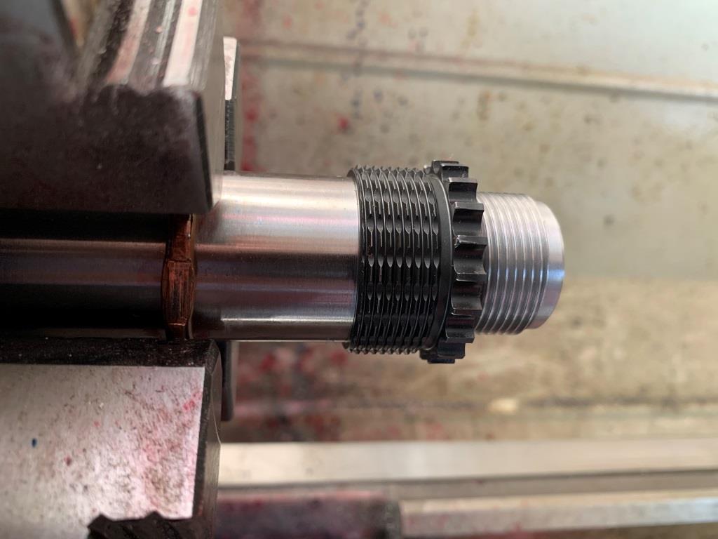

Does the unique shoulder on an RPR barrel serve any purpose? It is not related to barrel / receiver mating, and doesn’t seem to be needed for fore end mounting, either. Am I missing something?
It's similar to an AR-15. The barrel nut captures the barrel between the receiver face and the nut. The barrel is not threaded as in most bolt actions or the AR-15. The Ruger barrel is one piece while the AR-15 barrel and barrel extension are two pieces.
I've only seen one partially disassembled. I think it was a Gen 1 and I think the barrel shoulder was the seat stop for the handguard. I don't think later gens did that so it may indeed be useless.
I’ve turned down Palma profile barrels to produce the shoulder, for two different RPR’s. The one I’m currently looking at, nothing touches that shoulder, it just exists under the fore end nut & spacer. This gun is 7 years old, I’m told.
I think it may have on the Gen 1 and maybe 2 handguards.
It definitely does not on the Magnum models. I've been boring the handguard lock nut 0.050" on those so I can use standard 1.25" shank blanks.
On my Gen 1 & 2 RPRs, I used a hard shoulder to chamber and then threaded the 1.25" section to AR15 barrel nut specs. Bored the shoulder out of a standard tubular handguard nut to use AR15 handguards.
The primary motivation was using standard barrel blanks.
My comments just show how fuzzy memory can be - I just checked the take-off barrel from my Magnum RPR and it is threaded. The flange is only allow the barrel nut to lock headspace; the factory barrel has no shoulder in the conventional sense. It would certainly be possible to make a replacement barrel with a conventional shoulder, but it doesn't appear to be done that way from the factory. The replacement barrel from LRI (Long Rifles Inc., Sturgis MT) was set up the same way.

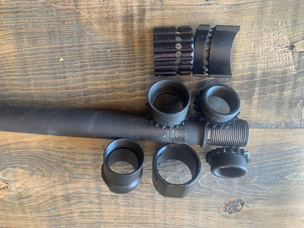

I dug out my take offs to take a look.
The top bits are the Gen 1. In addition to the barrel nut itself, there was another nut that screwed on it. It is stopped against the sleeve on the barrel. The serrated half shells clipped on that nut and the tube clamped on them.

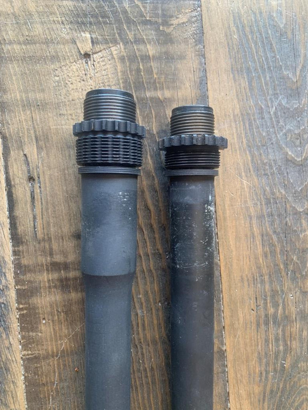

The bits below the barrel are Gen 2. The tube is a sliding fit on a bushing and held in place with screws. The bushing is held in place with another clamping nut that threaded on the barrel nut. The bushing is trapped between the retaining nut and the barrel nut teeth. The picture doesn't do a great job of showing it, but you can just see the points where the barrel nut teeth contacted the bushing. The sleeve isn't used in this assembly.
The tenon is a nominal 1x16 and the shank ahead of the sleeve is also a nominal 1". The sleeve is 1.175".

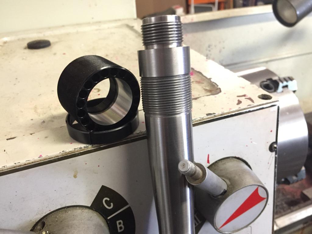

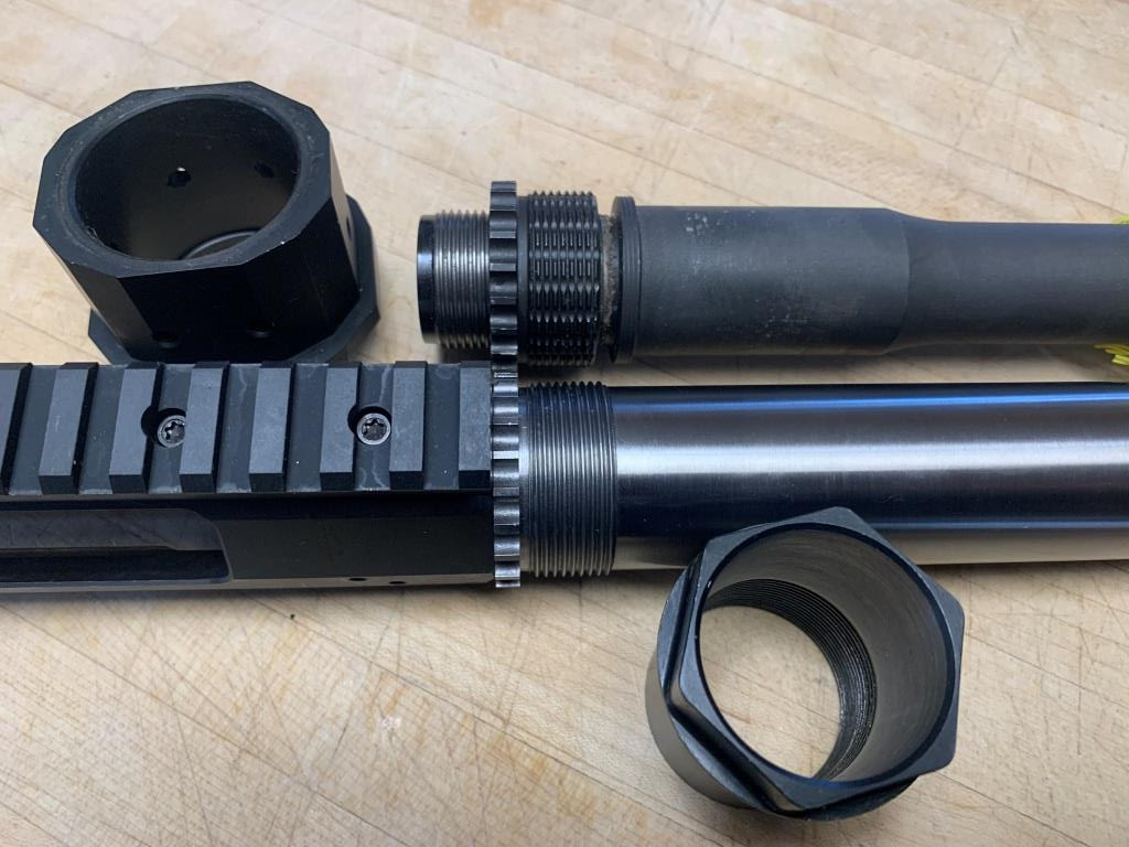

The conversion to standard 1.25" blanks went like this.
The Ruger forends were not reused.

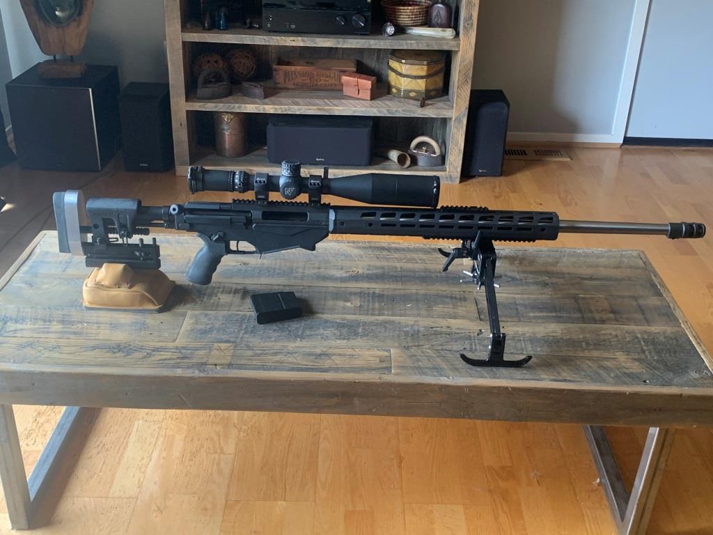

The completed guns.
One is a 6XC the other is a long throated 223. They originally had Gen 1 Razors on them. Those were robbed for later guns and they now use Gen 2 PSTs.
Things are scaled up with the magnum versions.
The tenon is 1.125x16 and the shank ahead of the sleeve is 1.2".
The barrel nuts both use the same AR15 pattern wrench, but the wrench will have to be opened up to clear the larger forend mounting threads on the magnum version.

Using a 1.25" blank is more straightforward with the Magnum versions. The forend retaining nut is simply bored 50 thou over.
I used a 1.35" blank for this one. I probably won't do another this way because of the additional blank cost. I also fabricated a barrel nut. It wasn't a necessary step to use the standard blank. The nuts are pretty easy to make from 1.625" round bar. The OD/ID threads and one face can be done in the first setup.
I like the forend on the Magnums and wanted to retain it. This requires the threads on the Ruger barrel nut. On the Magnum version, they're too large to just cut into the barrel. I was also after a more rigid connection than the 1.125" tennon would provide, so the barrel nut was set up trapped like a recoil lug. The connection to the front of the 1.25" blank seemed a little light, so I tried the 1.35". After assembling it, the 1.35" looks like overkill. The 1.25" looks like this;
Boring the retaining nut does not prevent it's use with the original Ruger barrel.
RPR Magnum set up for hobby level ELR.
The buttplate is fabricated from 1" steel bar stock and adds 3# to the back of the gun. The weight and shift in balance help with the tracking. Cartridge is 300 Lapua.
