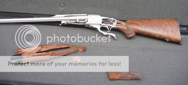

As much as I love #1's I wish more people would learn how to barrel them. They are a real nice classic rifle. I had one go south on me a few years ago. This is what happens when you use the wrong speed powder for the given bullet weight. It vented everything forward and I receiver barely a scratch. Though the action was toast and the the block locked it. Mark Stratten in OR thinks it was probably in the 70-75K PSI range. Even though it destroyed my custom rifle, I will build another.
