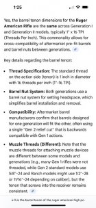

So, I'm wondering if that is a "nut barrel" that could be changed/replaced with a different barrel of perhaps better quality.
