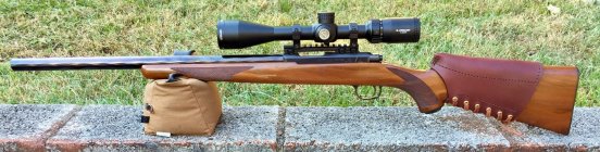

Here is my 77/22 I re-barreled several years ago. It was a typical 77/22 shotgun patterning rifle prior. I started with a Factory 20" 10/22 hammer forged Bull barrel with the spiral honing. Some of you may remember "Que" from the good old days of RFC. He set the barrel back and reamed it with a EPS reamer and cut the extractor slots. Ths was a v-block model but I did glue the reworked barrel back in. As you can see it groups pretty good @50 with a good lot of Black box or center x.
