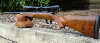

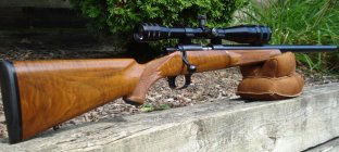

Mine shoots just ok and never really thrilled me. The factory stock is really nice. The SSV stock I put it in is even better.
and back to 513T's. Mine looks as good as it shoots....
Did the replacement stock reduce the weight of the rifle at all~?

It"s a custom build from on a 82 action, nothing stock about it.
I said it's a bench rifle... as in 0s and 1s .
Now what?
My apologies! I guess over the years I've seen too many people call their stock 82Gs a benchrest gun and I don't often hear of anyone who actually built a custom RFBR gun using a 82 action.
What did you mean by "now what"?
My guess is, do you have any more comments or questions concerning his 82 BR rifle? Remember, it's just a guess.
