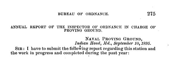

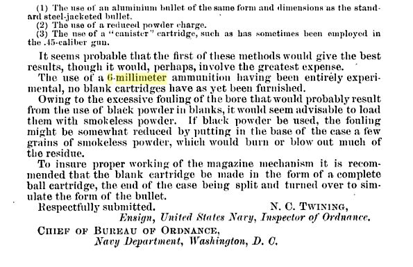

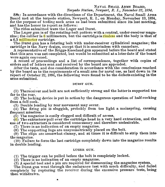

Looking at production ammunition for the 6mm Lee Navy, we see that the round the Navy eventually used was indeed rimless, but Wikipedia’s article on the 1895 Winchester-Lee rifle raises the question of what round was initially adopted – was it rimmed or rimless? Fortunately, we can find out for sure by looking at the Annual Report of The Secretary of The Navy from the relevant years of 1894-1895. We see in a discussion of a prototype turn-bolt Luger rifle in late 1894, before adoption, the 6mm Lee Navy was indeed rimmed:
K0Hr7pw
Page 306: Note the date of November 22, 1894. The rimless cartridge referenced is a proprietary 6mm round, unrelated to the Navy project.

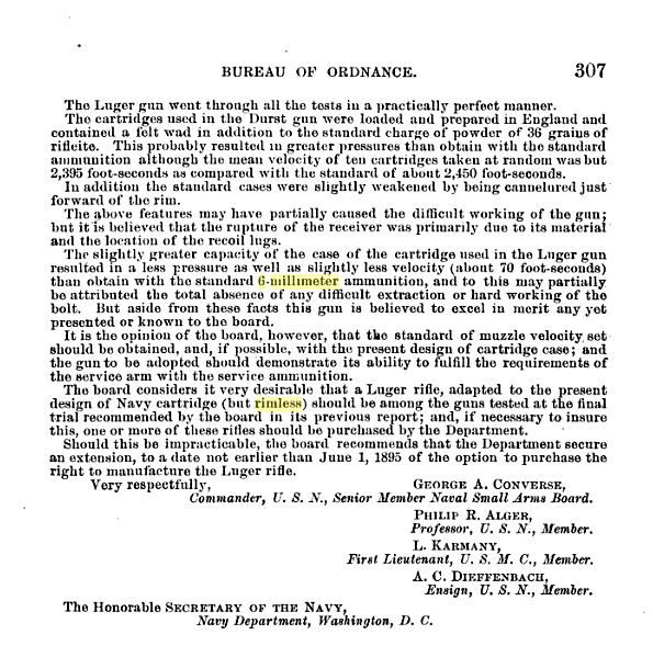

ELA1Ud5
Note the discussion of rechambering the Luger rifle to a rimless version of the Navy’s 6mm round, which at this point was still rimmed.

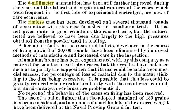

By July of the next year, however, the Navy had not only tested a rimless version, but it seems they had decided on it:
WteHrYS
On page 268, the second paragraph is ambiguous as to whether the rimless version is the current focus of the program or not.

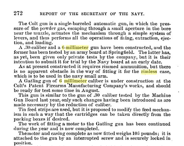

By page 272, the record is clearer that the rimless cartridge has been chosen for production:
BcEx09Z
76fTR1g

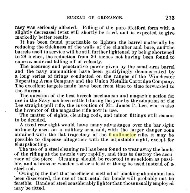

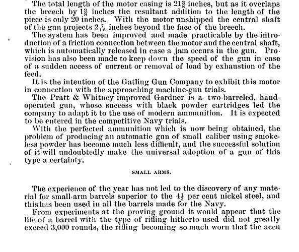

Note that the Navy is already having difficulties with the rifling wearing too quickly. A potential solution is the Metford rifling, adopted by the British for their Lee-Metford rifle in 1885.

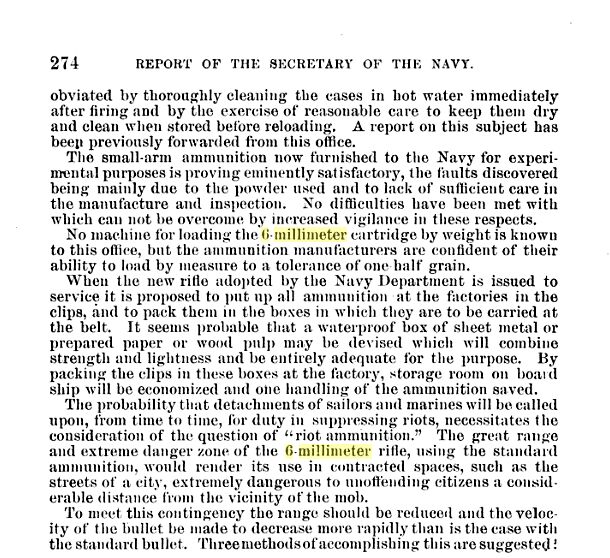

The discussion of ammunition continues on page 274:

Hopefully these documents shed some light on exactly what rounds were being trialed when. It does seem to make clear that the round adopted by the Navy in 1895 was indeed rimless, supporting the explanation for the semi-rimmed .220 Swift that the rim was simply expanded to match the common .473″ bolt face. The rimmed 6mm round itself went on to have a short-lived commercial career, as well, being made for the Winchester 1885 single-shot rifle for a brief time. As far as this author knows, no semi-rimmed 6mm USN ammunition was ever made by official order.

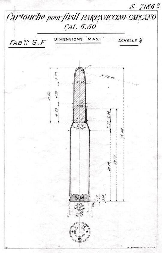

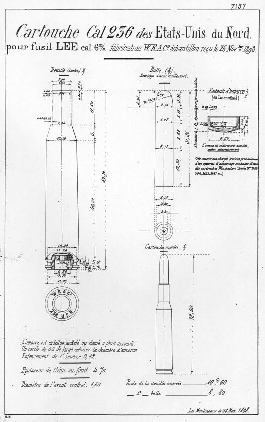

Finally, as for whether the 6mm USN was based on the 6.5 Carcano, we can reference two French cartridge drawings from the period for our answer:
US-(2) 7186B
Both rounds have substantially different rim dimensions. The rim diameter of the 6mm Lee Navy is listed as 11.27mm (.444″), compared to the 6.5 Carcano’s 11.50 (.453″), the Navy round’s rim thickness is 1.4mm, considerably thicker than the 1.25mm rim of the Carcano, and the extractor groove of the 6mm is significantly deeper. While cross-pollination of designs from Europe was certainly possible in this period (as evidenced by the Metford rifling being referenced in the document above), the case head dimensions of the two rounds, evidenced by drawings from the time, just do not match.
K0Hr7pw
ELA1Ud5
WteHrYS
BcEx09Z
76fTR1g
