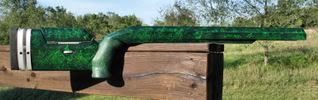

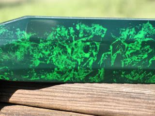

My gunsmith,Karl Kampfeld)received my Robertson GBF stock yesterday and sent me some photos.
I loved it! It was a little trick to decide which color to go. So I just sent him a picture of green McMillan stock I liked,posted on this site) and asked to make a marble/granite effect with the greens tones.
I also asked for a light texture on the pistol grip. Where I shoot is very hot so it will help keep my hands grip.
Now I am waiting for the action,Stiller Predator) and barrel,Krieger) to have it assembled.
Thank you Moderator and all the fellows here for the help. It is no easy thing to import a rifle, but I am sure I will like it when finished.
here are some photos of it:

I was dead set on a laminate wood stock for my F-class rifle, until I read this post. I can't get over how cool that your stock looks LR CAMPOS. That's awesome. How much would a fella have to shell out for one of these babies.
Hi Flybuster!
The GBF is around U$800,00. Not cheap, but it already comes with McGee International Adjustable Cheekpiece and 3 Way Adjustable Buttplate.
The color scheme is standard, you may choose the "granite" like mine, plain color, mix of plain color and granite etc.
I ask Ian,Robertson) to install a rail at the forend,it will not interfere with sandbags and will allow me to use a bipod) and put light texture on pistol grip.
The delivery was about 3 months since I finished the order.
Get in touch with him and I am sure you will buy one.
