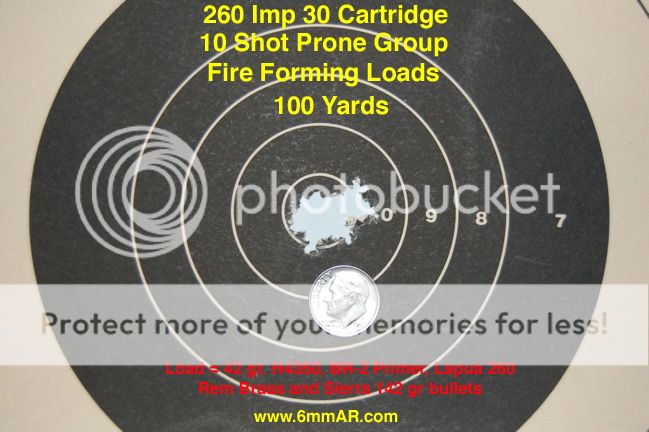

Fire forming loads can be very very accurate - so there is no need to always pre-form brass. In fact with the barrel I have on my prone gun I would not hesitate to shoot a 600 yard match with fire forming loads.
Here's an example of a 10 shot group I shot prone at 100 yards (i.e. not off the bench, just a shooting jacket and a sling). The load was 42 gr of H4350, new Lapua 260 Rem brass, BR-2 primers and Sierra 142's - - deadly accurate!
I really like that 6.5 mm cartridge especially for running the 139-142 gr class of bullets. Smaller cartridges like the 6.5 Creedmoor are good but I think they are really best with the bullets in the 120-130 gr range and they tend to labor more to run the bigger projectiles.
