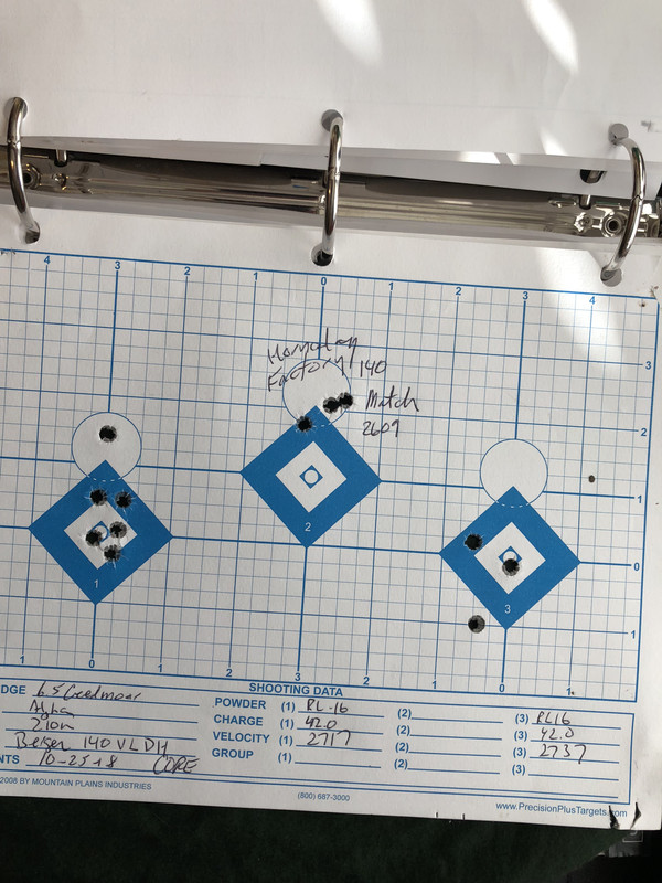

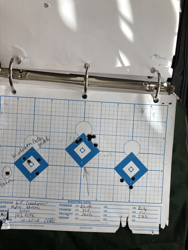

Not to good in my CORE , 20" Proof Carbon but i got velocity. This was first loads hurried for hunting season. I will work more with RL-16 after the season.
Tried RL16 with Berger 135CHB from Alliant web. 22” barrel it was alittle warm. Shot under 3/4 but not as good as my H414. I looking for alittle more speed. Back off 1/2 grain try again.
Had a good day to shoot and work with Chronograph.
Loading RL16 and H414 with 135gr Berger CHB: Remington 700 factory 22" barrel Timeny trigger 1.3lbs
Hornady Brass Trimmed Fed 210M, I found some. 35-55 degrees, start early.
RL16 43.5 2790fps SD 2.810
H414 43.5 2710fps SD2.825
H414 45.0 95grVmax 2962fps SD2.670
FYI: Going to kick the 95s up .5gr still under max by 1.5gr. JUST CAN"T be HAPPY
All loads under 3/8.
Shot some Hornday 140gr BTHP factory 2555fps also shot good.
