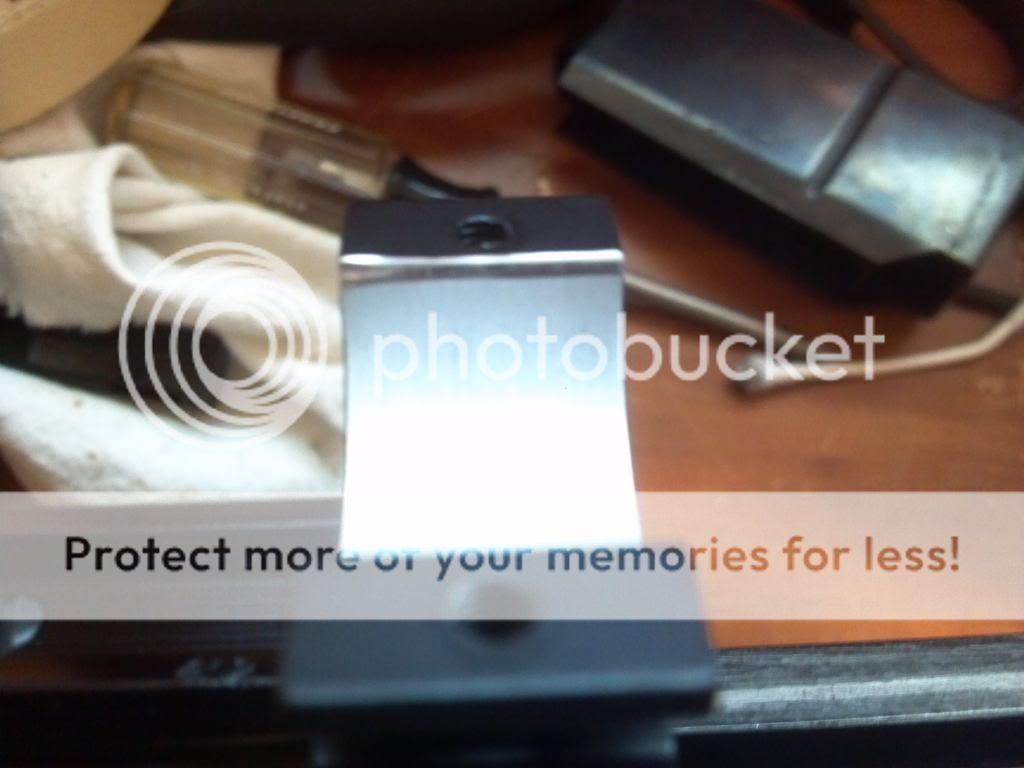

I know this is probably elementary for most but thought id put up some pics of rings i have lapped...As you can see in the first picture the rings have been lapped with just a couple passes to show how much of the rings would not be touching...the second picture is after a good lapping and show almost 100% contact on all rings. the rear receiver bottom half is showing just a little area that is not touching but this is where i stop...I usually shoot for 80% or better touching the scope...100% is great but for hunting applications i strive for 80% or better. The 3rd and final picture shows how i lightly relieved that area where the ring halves will meet. I have found that this is also a very important step. I use a dremel tool with a very soft stone wheel to just take a little off. Also don't forget to mark your rings to remember which half goes where. I didn't get a picture of it but I use a small punch to make a slight indention on the side of the rings while the lapping bar is in place. One dot on top and bottom front ring and two dots on top and bottom rear ring. Hope this helps some one..
Good illustrations. Keep in mind, the more you lap/remove, the closer the rings will fit together. Some rings have plenty of room, some not so much.
If you get into the not so much issue, bed the rings instead of removing more metal. Same effect.
Another picture of how lapping will show up a poor ring set up.
Lapping enlarges the rings and ruins any chance that the rings will clamp properly with even pressure around the circumference of the scope. Lapping the rings without bedding afterwards might be making thing worse.
The best results when fixing poor ring fit is to bed the scope. Lapping the rings is necessary to make room for the bedding material.

It is very similar to bedding an action. In my case I use shoe polish paste for release agent on the scope and sides of the rings. The bedding surface of the rings is left rough from the lapping and is degreased. As you can see from the picture the action is covered to protect it from accidental epoxy drops.
The top halves of the rings are left as is (not lapped nor bedded). It takes very little epoxy. After wiping off any excess epoxy that might be in the way, the top halves of the rings are installed with very light torque on the screws. I use 'Epoxy steel' and let it set overnight.
