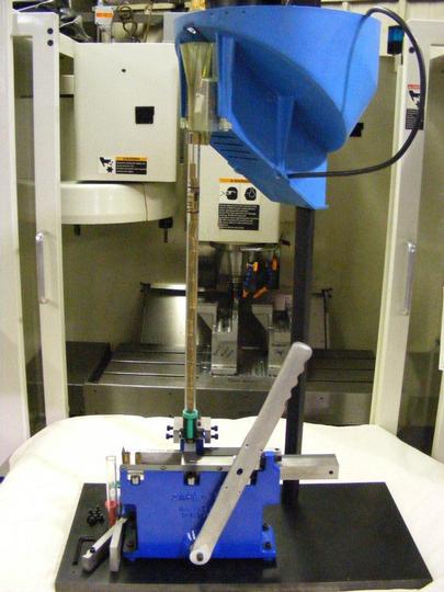

Just get yourself one of these and your problems are solved. Size cases in bulk and no lube required. Cases are "rolled" between two plates that have the same profile as an unfired case and it not only sizes to the bottom of the case, it also cleans up the extractor groove and rim.
http://www.casepro100.com/desc.ydev?prod_id=33744
Now all one needs is an extra $900 or so lying around 8)
