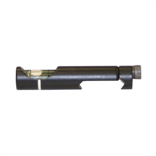

At home I took my rifle apart and the only lose thing on it was my bubble level. Would that really cause that much spread? Picture of my bubble level.
