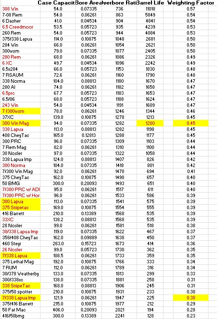

One of the more horrifying realizations you'll have about ELR cartridges is that 100 fps costs about 1/3 the barrel life and only moves the target 75 yards closer.
I started putting this together about 10 years ago to give a better perspective on the tradeoffs between case capacity and ELR scoring.
The names in red are cartridges I've tried with the exception of the Cheytac cases. Those were tested by a a shooting buddy who also chambered his own barrels. The yellow background are the barrels we've run to retirement. This is a little out of date. Use the 7RM mag for the 7PRC. I've retired a 6XC barrel since I've updated this.
In general, cartridges with the same overbore ratio (case capacity in grains of water / barrel cross sectional area in square inches) will give very similar performance with the same class of bullets. The larger calibers do perform slightly better but not so much that minor differences in conditions won't completely obscure any advantages.
Most of the ELR world has decided that cartridges with overbore ratios above the 416 Barrett, 375 Cheytac and 33XC are just not worth the trouble. More or less 100 fps below that are the 300 Norma and 338 Lapua Improved. 100 fps below that are the 37XC, 338 Lapua, 300WM, and 7WSM.
From the shortest barrel life in those groups to the longest over half the barrel life is cashed out to move the target 150 yards closer. I'm using around 2000 yards as the reference.

I agree with your major point of marginal benefits and a steepening cost slope when increasing velocity, in other words diminishing returns.
However I think your chart, similar to or the same as others I have seen, needs to use bore volume, since cartidge “volume” is being used.
It’s roughly the difference between squaring and cubing. The 50 BMG on these charts rates as extremely over bore.
The 50 is between a scaled up .308 and 30-06, neither of which is over bore. Maybe even exactly a 30-06, I seem to recall.
Anyhow, I think it is skewed in the chart. If a quarter bore radius is denoted as “1” then a 50 is “2”. The “cross section” area of these two is 1:4. The 50 is 4 times the area in cross section. However the 50 has 8 times or roughly that, of the bore volume of a .25 caliber barrel, same length. That will no doubt change things.

The overbore ratio is intended as a proxy for how long the throat spends at high temperature. I didn't invent it, I've just populated the table with data from the 2 dozen or so barrels I've been through in the last 10 years. I did a string of 3 wildcats based on the 338 lapua case with the idea of seeing how far the overbore could be taken and how to model them in QL. Using the same case and measuring the extractor groove expansion on the first firing kept the peak pressures similar from cartridge to cartridge. Then added another 6 Cheytac barrels, 3 in 338 bore, 3 more in 375, that I know were used similarly. That'd be strings of 10-15 at a 20-40 second cadence. A pretty standard ELR cof.
The temperature tracks with pressure. A larger case is a higher volume tank for the pressure, a smaller bore is a slower leak. It's not intended to be a dimensionless number like Mach. It'd have units of length if the volume and area were converted to common units. Leaving the inputs in their common format makes them more intuitive and errors easier to spot.
Another analogy is holding your hand over a candle. Larger cases in the same bore are like holding your hand over the candle longer.
This is a common entry point into a barrel life calc. It's not the final word. Single vs double base powders, peak pressure, string length, and shot cadence all heavily influence barrel life. Your 50 barrel may last a lot longer. I've spent way too much time in the woods with a 50bmg bench rest shooter and I'm absolutely certain he'd laugh at the idea of a 50bmg bench gun with the barrel life of a 30/06.
With the leaking tank analogy in mind, let's look at the 30/06 50bmg scaling thing.
Bore diameter ratio - 1.66
Case head diameter ratio - 1.71
Case length ratio - 1.57
The length ratios check.
Bullet weight - 647/150 = 4.3
This usually scales to volume, or cubed. 150 x (.510/.308)^3 = 681. Pretty close
The case volumes are (300/68) = 4.4
The bore areas scale to (0.511/.308)^2 = 2.75
So the tank grows faster than the leak does when case length and diameter are scaled up to bore.
I was off on the volumetric ratio, FeMan. Pi cancels, height cancels and the ratio remains 4:1 when you double the radius from one barrel to another. 8:1 is not right; it was the ratio of the volume of a 2 inch block to a 1inch block, but the 2 inch block is twice as tall.

The 338 Snipetac and 7/338 Lapua Improved would put jacketed bullets through a free hanging 1/4" mild steel plate at 1200 yards. Great fun while it lasted.
That table isn't intended to be a barrel life predictor for everybody's barrel. There are other significant modifiers and a given barrel might last longer than the last. Probably not twice as long, probably not half as long. It's only intended to assign a reasonably representative value using a simplified equation to that side of the case volume decision. It's centered on 300WM and falls apart much smaller than maybe 280 or larger than 26 Nosler? Thats the range of case capacity to bore ratios I'm interested in, so it's an effective model for that. I don't think it's a coincidence that the popular ELR rounds have similar values for that metric. I'm not just following the leader. I've tested that electric fence several times and the harder you push on it the more it stings.
Most people hang on to their barrels too long, particularly the first one. I've never been disappointed with a fresh barrel. Early on, I had barrels that were found to be blowing bullets up just before 200 yards. The 5 shot groups were still between 3/8 and 3/4". No lead mist on the paper either. Dropped the velocity 250 fps and it didn't help much. Maybe not pressure, maybe not rpm, I came to the conclusion it was most likely the throat.
With ELR, the barrel starts contributing significantly to BC variation as it ages. This happens long before bullets start bursting or groups open up. It's easy to have what I call a peaked in high school setup. A round that looks great from a velocity and BC standpoint, but the smaller rounds with fresher barrels just run roughshod over it beyond a mile. If the gun is shot at 1k or less, especially at the hobby level, it'll be many more rounds before the impact of BC spread is noticed.
