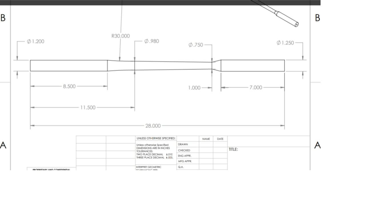

Hi Folks,
Can anyone tell me if reverse taper barrels have ever been known to work on a centerfire rifle? I've seen them on some very tight shooting rimfire rifles before, but not on a centerfire. Is the idea that the weight and the end of the muzzle slows down vibrations and widens nodes? Here's a pic I stole from another site

See “dog knot”
You guys need to read the rulebook. Not illegal in NBRSA. I have used one and it worked OK with a tuner in 6PPC. I gave the other to Pat Byrne. I don't think that he ever chambered it.
As I said, read the rulebook.

Mike, read the rules as you copied. You are not reading it as written. Read it as written. It describes a taper, but says it must be within the specs. If the taper is within the taper, it doesn't matter what the taper of the barrel.
hmmmmmmmmm... I thought the rules prescribed a continuous taper from the cylindrical section to the muzzle.

The sporter class is the only creative class. Youre right on the lv/hv pretty much. Cant be a straight section on there from 5” forward to the muzzle
So back to my original question - do they work? If they were allowed in the rules, do you guys think we would be seeing them? I shoot f class, so barrel taper rules aren't a problem for me

I think with the barrel motion a centerfire has any type of hinge point would make it swing so wildly you may even miss the target. Stiffer is better. Thats why a 22” barrel most times shoots better than a 26” not counting the weight limitations. Rimfire barrel motion is way different and not even really comparable
The barrel shall not be less than 18” long forward of the bolt face and a diameter of not more than 1.250 inches from the bolt face forward 5 inches. From said 5-inch point, the diameter shall not be greater than would be defined by a straight taper between such point and a muzzle diameter of .900 at 29 inches
Read this as written. It has been addressed before. The only thing that it says is it must be within a straight line from the 5" point to the muzzle. It can be butchered in any manner as long as the barrel is within the Imaginary line.

Yes Butch, it could be done. I never said you couldn't, BTW.
Yes, by my estimation, the barrel shown above can be used at about 18.5" long if you don't cut anything from the tenon end...AS DRAWN.
FWIW, yes, I have cut hinge points in barrels and it does work similarly to how a reverse taper works. I'm working with a couple of barrel manufacturers now, to offer a contour that is designed to be optimal for use with a tuner as well. Same principle but it's not a reverse taper nor does it use hinge points. I'll share more on this at a later date.

The first “dog knot” barrel is saw was about 1977 on Colonel Charles Atkins’ 280 silhouette rifle. The rifle was barreled by Wayne Leeks at Remington. I would say he knew what he was doing.
