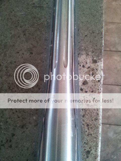

I recently rechambered a gun with a smaller contour barrel and I had a large, uneven gap between the barrel and the stock. I know this is only aesthetic, but I like my guns shooting and looking good.
I simply got some 20 mil tape and put 2 layers lengthwise on the bottom half of the barrel
http://www.amazon.com/Orbit-Sprinkler-System-50-Foot-53550/dp/B0013I71Q4/ref=sr_1_1?s=hi&ie=UTF8&qid=1395623125&sr=1-1&keywords=20+mil+tape

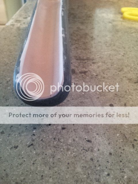

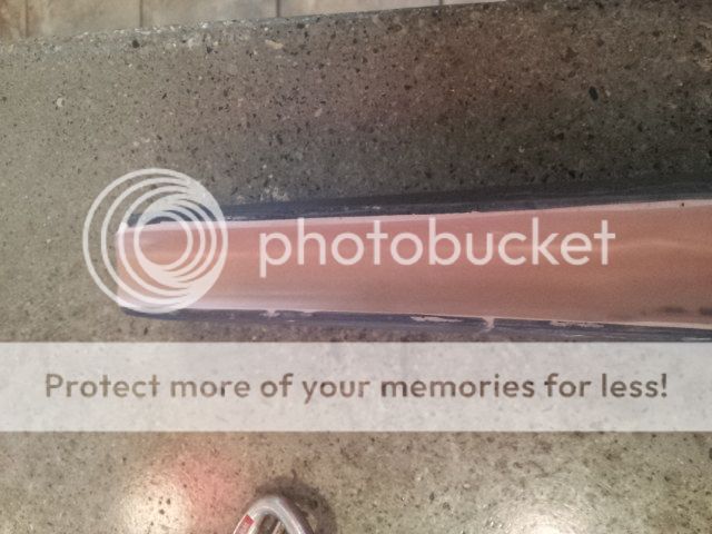

Next I got some Walmart bondo, mixed it applied generously to my stock channel.
I then put my barreled action in the stock and tightened it down.....30 minutes later and a little cleanup and it is ready for paint.

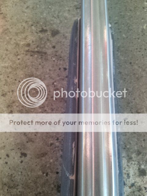

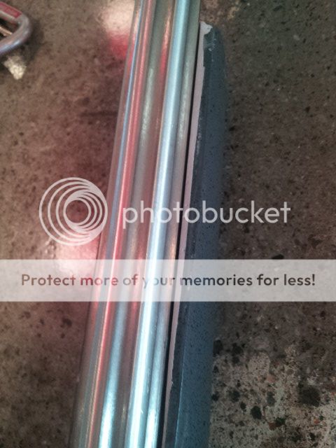

What you have when you're done is a perfectly free floated barrel with a very even reveal
