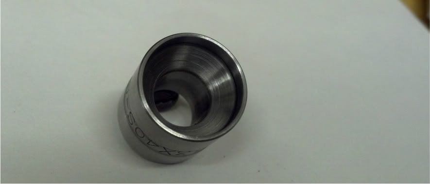

Here is a picture of one of Neil's "bushings".

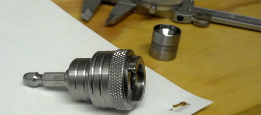

Here is a picture of the 21st Century "do-dad" that I'll use to spin the case in the lathe if required. You can also see the bushing in the background as well.
Yes that is the same tool as the one for the lathe, only difference is the length of the driver, I have both, nice holders ;)
Wayne.
