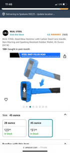

Can someone please post a picture or a link to a dead blow hammer ?
I would like to know exactly what this is ..

Did most of that. Too cheap for a deadblow, I even looked at harbor freight. Too cheap for the drywall tape too lol.

I also call a little sledge hammer a single jack. Never heard of double jack. Figured nobody would know what a single jack is. I dont see how a dead blow makes a difference other than not damaging the handle of the action wrench, which I dont care about. A dead blow is not just coated solid steal. They have beads or something in it.

Aside from the reduced shock on your hands, a dead blow keeps its forward momentum when striking something springy. This is not just safer, it transfers more total energy. (If your hammer is bouncing, it’s not transferring energy well)
