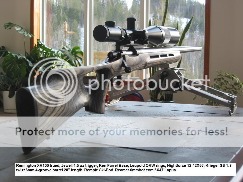

This is a 6BR Norma
This one is a 6X47 Lapua...
My 6BR has a Krieger 1:8" twist in a #17 contour, stainless and .236 lands. .272 "no-turn" chamber optimized for berger 105's.
