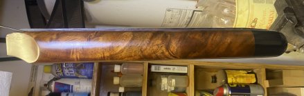

I have a beautiful 17 A&M Bee barrel for a Stevens 44 1/2 and a stock set, and an action. I’m going to try and get it together and fire a few 17 Ackley Bee rounds to get fired cases and have a FL size die made.

Wow what a great looking rifle.
Please show us a couple more pictures when you get it together. With both the new and old stocks.

I’ll be sure and do that.
I bought the barrel and fore end not knowing what I had bought, but thinking it was probably a 17 Javelina rimmed using 222 Rimmed brass. It got here and it wasn’t that, but a 17 Ackley Bee dropped right in. The fore end was thrown in. It was black when it showed up here, but cleaned up nicely. It wasn’t a 17 Ackley Bee, the shoulder was too far forward. So, what is it? I thought perhaps 17 HeBee. Finally I stumbled on what it is.
I have three 44 1/2 rifles and figured on fitting it to one of them. Then the seller contacted me and ask if I was interested in a 44 1/2 stock. Yea sure, why not. It obviously was solid and I can always use something like that. It was a nice looking piece of wood from the get go, but nothing special at first. That nothing special kept getting better with each coat of Pro Custom Oil drawing more and more of the oxidized stain out. It is really pretty now.
One of my actions (the 218 Bee) has the barrel pinned permanently to it, one has a 219 DW (30-30) extractor, one has a Hornet extractor and I guess I have four, one has a RF block. I let it be known that I’m looking for another nice action and this came up. The stock is broken, but it has a nice 38-55 barrel on it. I’ll get some use out of it.
So, that’s where we are currently. I’m going to need a Bee extractor and I probably have the missing screws here. It surely can be up and running by March and chuck shooting season. I might not be able to reload the cases after they are fired until I get my die, but there’s nothing wrong with shooting fire forming loads at chucks.
