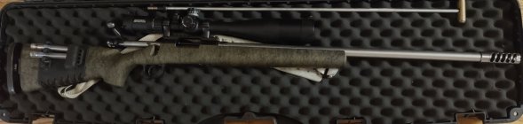

Just an update, this is where it now lives, .45 1-20 Brux, SML shooting 275 Pittman land riders. The Sako extractor works well with the primer modules. First blood was this week on a mid size doe.
