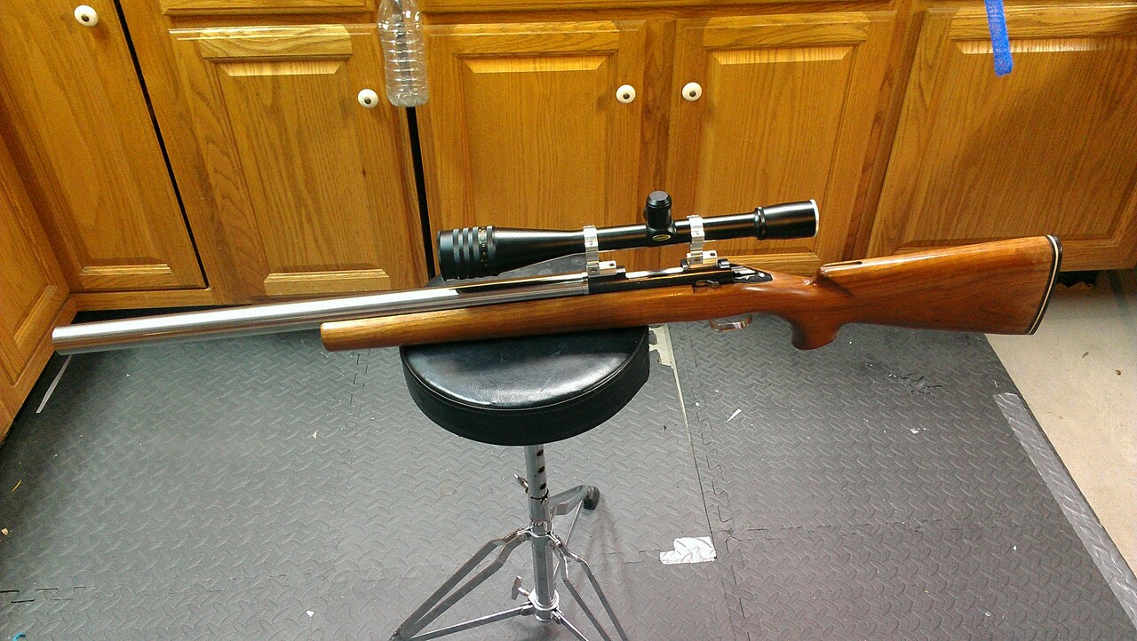

Oh yeah...great varminter. I think the barrel is the most important part of making a 40x a shooter...
1.25" straight in 22BR:

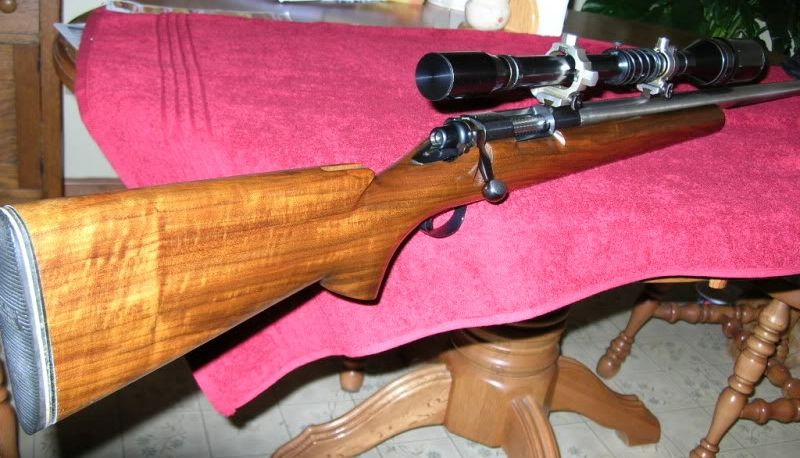

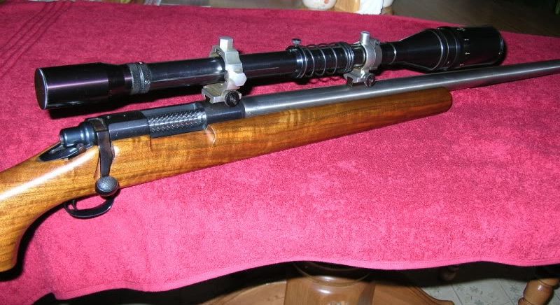

Here is a 40XB Rangemaster I bought new in the mid 70's. It's a single shot rifle in 7mm Remington Mag. Because it isn't built on a long action, the bolt must be taken out to remove a round that hasn't been fired. One photo is of two groups fired at the factory, which were in the box with it. I still have the palm rest that fits in the rail on the bottom of the forend. IMHO, it's a fine rifle, and I have made some unreal kills on faraway groundhogs back in the day, also shot some great groups with it. I once owned a similar 40X in 6mm Remington that was a genuine dog, so it didn't stay around long. I remember the short benchrest model with the flat forend which was a 40XBBR. Almost bought one once in 6x47 but figured if it had been any good, it wouldn't have been in the used gun rack begging for a new home.
Better photos of the stock, when it was wearing the old Unertil
