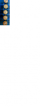

Here is an attached picture of what the primers look like, this is with a mild load and gave me 2500 ish fps with an 80 grain smk

Are those bolt face marks on the head stamp area? I think some guys mic the brass at the base area and compare it before fired dimension. Once again I am no expert but have doing quite a bit of research trying to gain some knowledge so take all this with a grain of salt. As to the cratering, ya I would call that a crater lol!
Headspace issue? (case too short for the chamber,firing pin hits primer pushing case forward, primer goes bang and tries to move out of pocket while sending case back against bolt face causing dished surface)

All thanks for the responce i will look at the bolt face and see if the firing pin hole looks sloppy or chamfered.
I will try an rechamber the fired brass to see if i can get the bolt to close. But why wold i get these marks even on virgin brass.

Once your head space is correct do yourself a favor and send your bolt to Gre-Tan to have the firing pin hole bushed and the firing pin turned. (or bushed and just buy a Gre-Tan firing pin assembly) I have worked on accurizing dozens of Rem 700's and will not even begin to load test anymore without having this done to the bolt and firing pin. Best money you will ever spend on your Remington. If you have primer problems after this then you have the wrong primer or a very hot load.

Remingtons tend to crater the primer at safe loads. Fix is to get the firing pin bushed....Gre-Tan is the place to send your bolt.
Thanks to all the responces I guess the next step is to send the bolt to Gre-Tan an have the firing pin bushing treatment.

You do not have a pressure problem.
Federal primers have thin cups, and your firing pin hole is over sized. You might consider switching to CCI 450 or Rem 7-1/2 next time.
Just neck size the cases and enjoy it.
