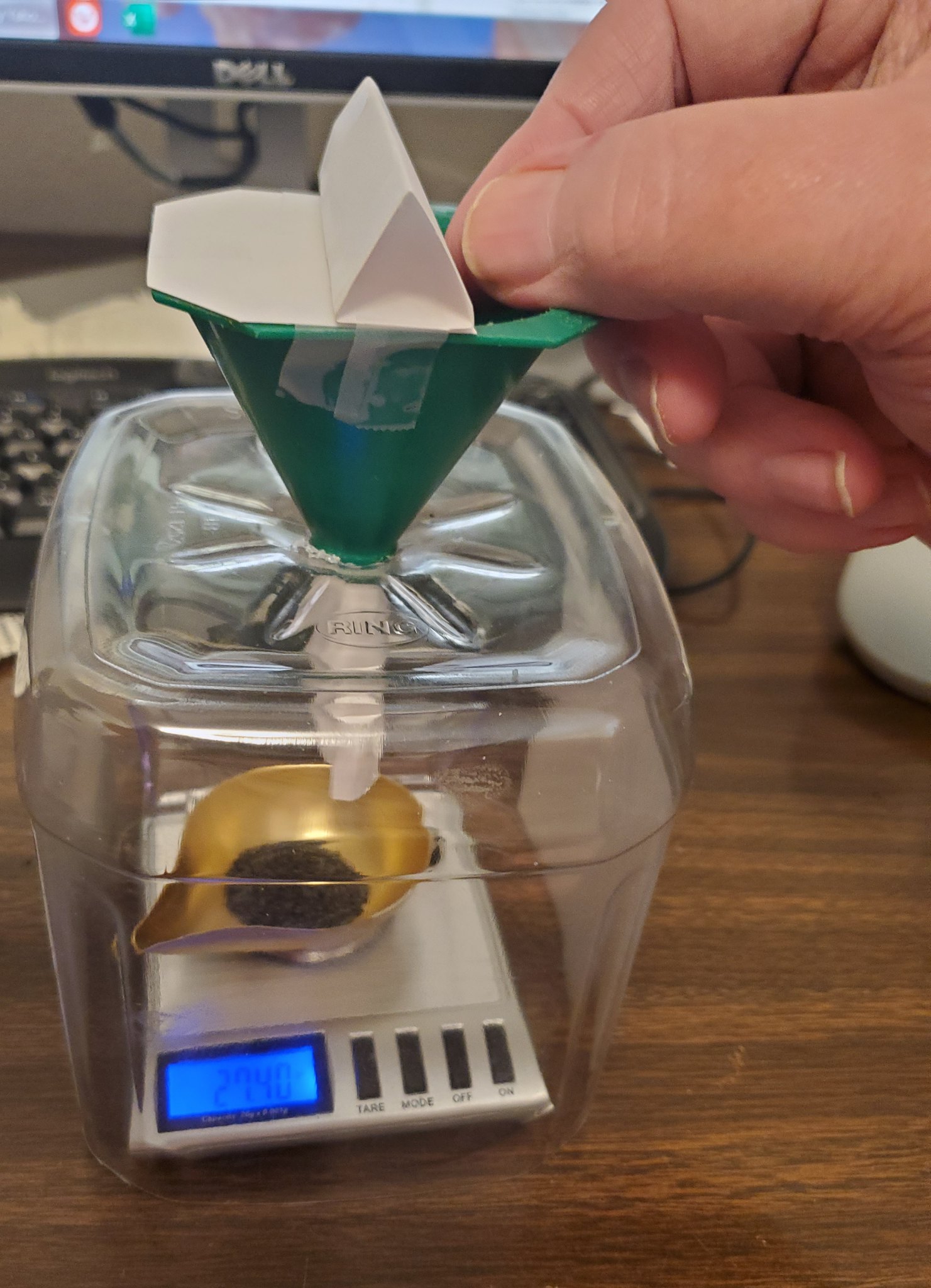

I can throw light, and pinch trickle within +- .05 gr. in under 30 seconds.
I use the same pinch trickle technique. It still amazes me that my fingers are sensitive enough to I can actually pick up one or two kernels of stick powder to top off a charge. Seventy five rounds charged to plus or minus .02 gns with bullets seated takes about an hour to a hour and a half depending on interruptions. Love that improvised wind shield
This is what I used.
