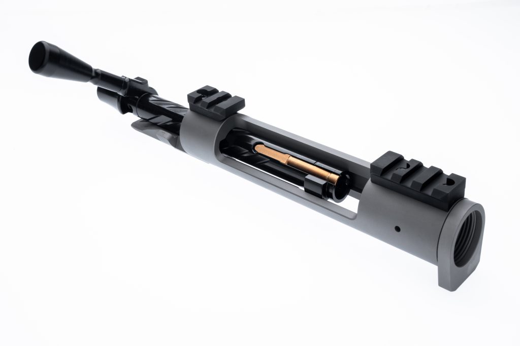

It's that season again. Do you guys have any recommendations for actions with a remington 700 long action footprint that can take pre-fit barrels? Is it better to try to find a custom 700 la receiver that doesn't have an integral recoil lug and then swap it to a remage lug, or to get a nice action designed to take pre-fits. Some people here have previously recommended the Zermatt actions as well as the ARC mousingfield, which seems to be out of production. I'll take any advice you guys have.

Zermatt, Mack Bros, Kauger. I'm not sure why you wouldn't want an action that can't take prefits.
You can still have your smith measure it and chamber a barrel specifically to it for a shouldered barrel, or use a nut if you want.

I agree on the Mack bros action, they are quite nice. As well as the kelbly atlas, the new Prometheus has integrated lug and more tenon threads.

Kauger Arms. Hands down across the board the best action on the market for the price. Maybe at any price really.
