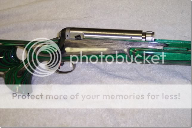

Off the top of my head, I would say the Savage nut is about one inch long and the thickness is about the same as a conventionally chambered barrel just ahead of the action. If you're wondering about how it would sit in a stock - well, don't worry about it.
Here is a pic of a Savage Target Action with barrel nut sitting in an unmodified stock.
Thanks for the info,
The reason I asked, is that, I have a 1" diameter bbl, and the stock width where the bbl nut would go is 1.300" wide o/s edge.
I have concerns that barrel nut may creat a thin spot in the stock at this area.
