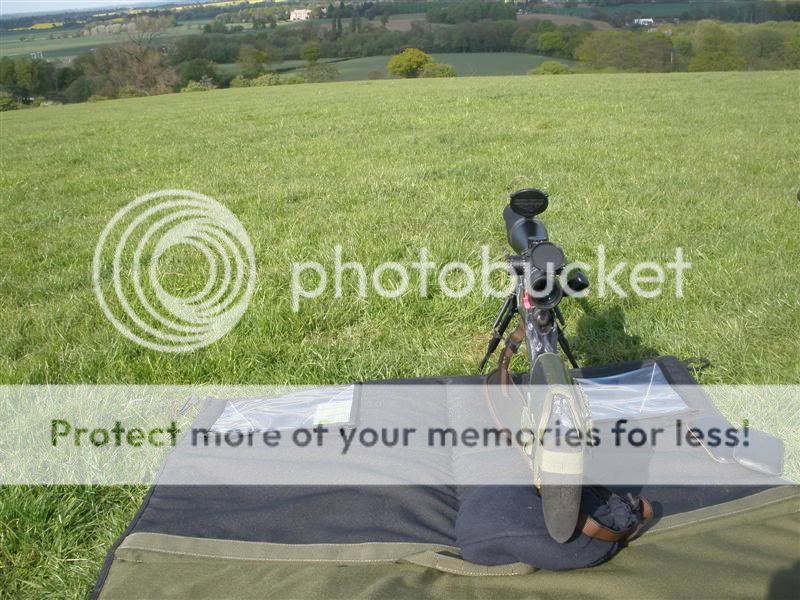

I love my rifle, it's a .243AI built on a Remmy short action.
I can't fault it!
The local foxes don't like it!
It is an excellent long range varmint tool.
