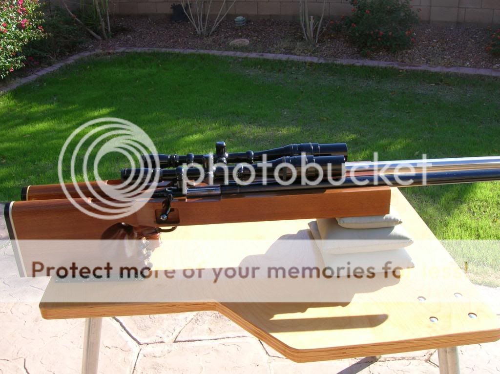

These are my 2 Heavy varmint rifles I built back when I lived in Ohio for long range groundhog hunting.
The Blued barrel one is 25-06 with 1.250 Dia. barrel and
The Stainless barreled one is 7mm/300 Wby with a 1.350 Dia Hart barrel built just like Mary Louise Devito's rifle that set a 1000yrd benchrest record of around 7 inches back in 1970.
Dmoran, Now you have seen one ;D

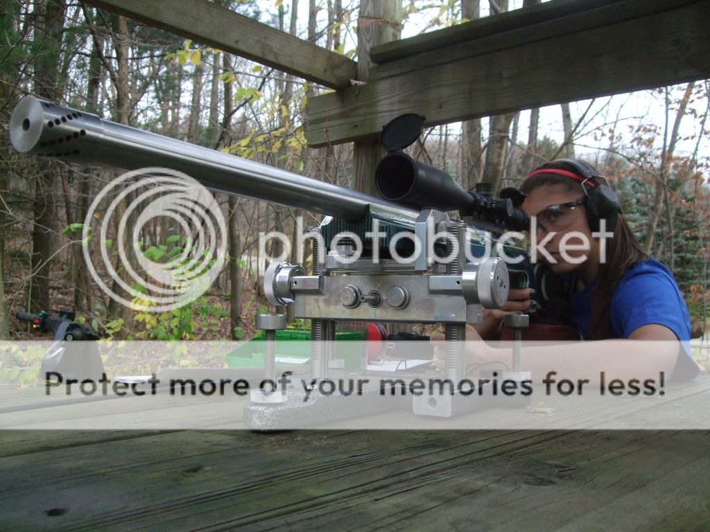

Here's a couple of pics of 2 fat barreled rifles..
The top one is a 32" 1.450 on a BAT L I built for my mentor kid's 338 UM....
The bottom photo is my 32" 1.350 on a BAT M, 338 UM being shot by my mentor kids sister....
