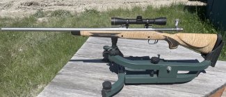

I found the stock a few years ago and it spawned an idea. I then found a used 7mm mag stainless rem 700 in an HS precision stock. Sold off the stock and barrel and brought the action and stock to my Local Smith. He order a Lilja barrel and chambered to 375H&H . He cleaned up the action, opened up the rails so it would feed properly and worked the trigger down to 3 pounds. Finished project turned out just like I hoped it would. Groups 300 grain accubonds under an inch but it’s a lot to sit at the bench and trigger a box of ammo.
I think it’s a look you either love or hate. I love it.

Just my humble opinion though. Thanks for the kind words on this rifle build guys, I do enjoy the way it turned out, appearance and performance wise.
I never have gravitated towards the blonde stocks. That being said that looks great, beautiful piece of wood and the dark accents, the butt pad, pistol grip cap, forend and dark checkering tie in nicely with the matte scope. Nicely done.
