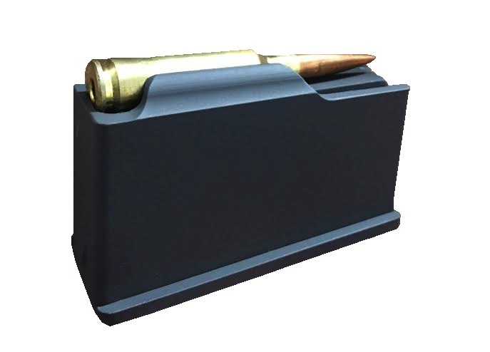

http://www.curtiscustom.com/product/magazines/
I guess I should have bought a few extra when I had the chance (and when they were less expensive than they seem to be now). Kidnap-style photo for proof. :)

But, if you must.... I believe accurate ordnance will make you a flush fit. Or was it SAC?
Or, you can just order it from here and have it in 3 days....
http://www.piercisionrifles.com/curtis-custom-flush-3-round-308-magazine/
