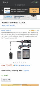

What's a decent bore scope? I can purchase to start...

I just upgraded to the Teslong rigid borescope with wifi adapter. Works on 20 cal and up. Pretty awesome

9 - If you want a borescope the Teslong can be found at Amazon for $50, they work amazingly well but they are better to judge how clean a barrel is than anything else. I have seen barrels that are alligatored 3 to 4 inches and they still shoot 1/2" groups, I have seen other barrels that looked near perfect that do not shoot well at all. So don't put a lot of faith in what you see with the borescope unless it is something really bad like missing lands, etc.
