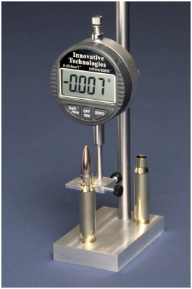

The answer to your resizing problem is to always use a FL die, and set the die height "accurately". Take a close look at the Digital Headspace Gauge. It measures the exact clearance (at the shoulder) that YOUR handloads have in YOUR particular chamber.
I just love this thing.
Innovative Technologies Digital Headspace Gauge
