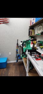

I like to stand when I reload and the stand puts the press at a more comfortable position for that. I have two presses and have a separate stand for each. I use T-Track to hold them down and store the one I'm not using in a cabinet. I use the box to put the scale at eye level so I don't have to bend over to read it. I flip it 90 degrees and use it as a stand for a dovetail jig when I don't use it for reloading.
For me it was 2 fold. I wanted a bit more compact means to store my presses while not in use. I also built my bench to load standing or sitting on a srool. While standing was pretty decent my stol put me just a bit to high. I have t track and made woode "plates" to bolt them down to the track but the bas plates took up a bit to much room for my liking. I recently installed a 4" mount and its at the perfect level. Ive deprimed apx 2500 223 on my t7 in the last 2 days and im very pleased with the height. The old plarws raised my press 1.5" the new ones is 4 so wasnt that big of a difference but made all the difference.
