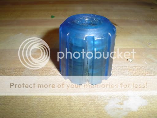

I got in a Forster collet puller the other day. I can't keep it from marking up the bullets real bad.

I use a kinetic puller. I use a shellholder instead of those three pieces in an oring. It is a little slower but the shellholder makes It easier. Not sure how it would work on crimped bullets. Matt

However I have used a kinetic puller for decades. Never used a shell holder as it never occurred to me. Actually hate pulling bullets this way and fortunately have not done many. Never a discharge. Then years later I wound up with a large amount of 6.5 bullets to pull. 6.5 x 284. Given to me. Decided to buy a collet puller. Got the RCBS one. Found it not only worked perfectly but was way faster though time was not a concern. You use a light touch on the collet and it has never marked a bullet. One day I screwed up and had about 50 rounds loaded too short (cbto). Put the round in the collet and gently raised the bullet. Put in a correctly adjusted seating die and problem solved.
I guess the collet puller can serve TWO purposes.
I have read abut the alleged danger of a kinetic puller somewhere else also and with using a shell holder. It never really made sense to me. But I did eventually buy about 5 different collets as it worked so well. A good tool that I hope I don't have to use too much!
