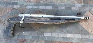

Wanted to do something different with a Remington action and 6.5mm barrel I had so I built a 6.5 creedmoor pistol. Am starting to do some testing with reloads and guessing it might work better to use a faster burning powder in this short 12” barrel. I did shoot some of the rounds I had made up for my rifle and speed was 300 fps slower than when shot through my rifle. Not too bad but I betting not all the powder is getting burnt before the bullet leaves the barrel. The pistol is really fun to shoot so I decided I need another. Got parts ordered to build one in 300 Win Mag. That one will definitely have some unburned power leaving the barrel. Might not be getting much more speed than I would if I chambered it in 30-06 or even 308 but I just got to do the Win Mag just because. What are your thoughts on powder choices for these shorter 12” barrels? Right now I am using IMR4350 for the 6.5 Creedmoor rounds. Attaching a pic of the pistol.

Can’t help ya partner with your questions but you have a nice looking pistol for sure

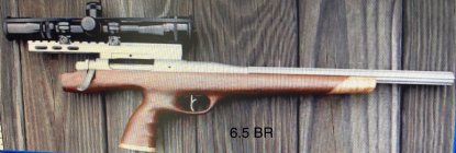

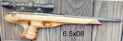

Built/shot a few XPs for and in competition, the first 6.5x08 pre 260 Rem, I used H-414 to develop loads with 120 SMKs set .003 off the lands, running at 3,000 fps. This load in my R-700s, five, and my Armalite AR-10T did 3,215 fps. I have a montoge of five groups, largest is .13 inches in the AR. The 6.5x08 XP would take your breath away, with it's internal 7 row break. A 6.5 at 3k plus fps has a very noticeable nuzzle blast, at 3,800 fps the muzzle blast is shattering if you get even or slightly out front.

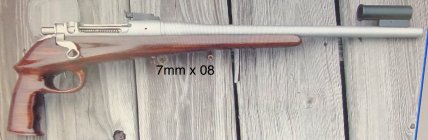

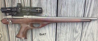

Built a 6.5 BR and used 2015 BR with 120s. Built a 7BR, used 748 a 7TCU used 748 and 4227, a 6x47 used 2015 BR and of course the 7x308 with 748. The 7s with 130s, 140s, 145s and 160s. 6mm with 100s. When I retired from competition 8 of my XPs went to other shooters
