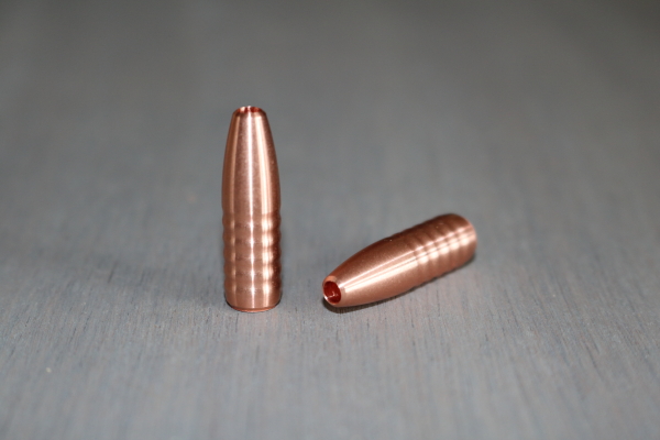

If I was loading for a 30-30 I would consider these.
