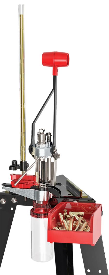

With the difficulties of getting equipment, I still have a couple of things on backorder. However, I've also been able to pick up a few things. My questions are: should I still get my back-ordered items or will one take the place of the other? And what would be the next thing to get?
What I have:
Lee Deluxe APP Reloading Press
Lee ACP w/ Depriming Kit
Hornady Cam-Lock Case Trimmer Kit
Backordered:
Hornady Lock-N-Load Single Stage Press
My plan is to start with .380 since I have the brass and bullets already, as well as a 4-die carbide set.
